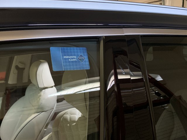

Palisade Window Gasket gap.JPG I stopped by the dealer yesterday and the Service mgr. said they had one other complaint. They believe its a gap between the window and its gasket. The attached photo shows one area that doesn't have a good seal between the glass and the gasket. There are other areas forward which also don't have a nice compressed seal. The dealer indicated they will be ordering a new gasket and I go in on 9/16 to have it installed. Hope this works. I believe the window alignment can also be adjusted but probably requires removal of the door panel. I will let you know how this works out.

Update: I went to the dealer but they only confirmed that a new gasket needs to be ordered. I have to reschedule for a day or two. Will let you know if this solves the problem.

My gasket installation appointment got delayed. It is now scheduled for 10-3-19. I will be sure to let you know the results after it is completed.

I just returned from the dealership having completed the window gasket replacement. Unfortunately, this did not fix the problem. The shop foreman indicated this was a known problem and said you could take a new Palisade off the lot and observe this problem. He said they would initiate a case number and get a response from Hyundai engineers. Not sure why this hasn't been done already, but that is the state of my vehicle at this time.
