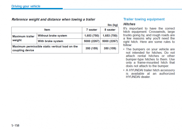

Hi All,
I can't seem to find a straight answer about the maximum towing capacity ball-weight for the Palisade.
Are they different around the world?
There are various terms for the same thing:
  • Tongue weight / tongue load
  • Ball weight
  • Down-load weight / down-load limit
  • Hyundai call this the "maximum permissible static vertical load on the coupling device"
Confusing stats from around the world:
100KG (220 lbs) @ Hyundai Australia web page
https://www.hyundai.com/au/en/owning/servicing/roadtrip-p
150KG (330 lbs) @ Hyundai Australia correction via Auto Expert
https://www.youtube.com/watch?v=GvC8ny84F4E
159KG (350 lbs) @ Hyundai USA User Manual (5-158)
2020 Hyundai Palisade Owner's Manual
226KG (500 lbs) @ Hyundai Canada User Manual (5-158)
(Note: they have the lbs / KG numbers mixed up)
https://www.hyundaicanada.com/-/med...manuals/english/2021/palisade/lx2-can-e-5.pdf
Thanks in advance.
Pic from USA User Manual

I just looked in my 2021's manual and Hyundai has updated the max "static vertical load" to 500#. And they have an explanation of tongue load on the pages preceding the limit.
I'm late to the party, but in US, from what I've seen, all 4 trim packages have a spec hitch weight of 500 lbs. However, 2020's had different specs for different trims.
