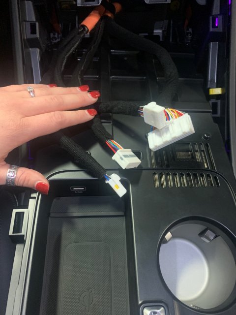

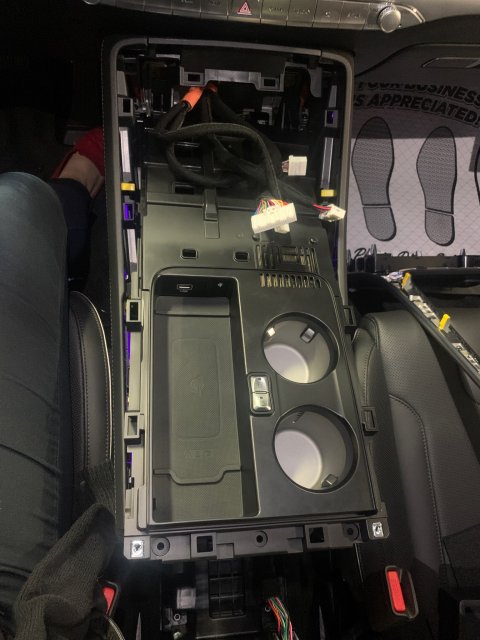

Do you know which wires on the cooler/heater are ground and + wires?
If you have the wiring diagram and post it on here. Someone may be able to help
Maybe take a picture of the wires for the cooler/heater

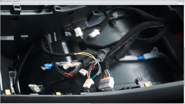

Ok, it seems like there are 4 wires that need to be spliced into. According to the other installation guides I read for different hyundai vehicles.
http://www.tuixmall.com/info/installationview.do?type=car_shop&pk=59 Maxcruz
http://www.tuixmall.com/info/installationview.do?type=car_shop&pk=60 Tucson
These two seem to be just plug and play. But a little more info, one should be a 12pin connector that connects to the PRNG gear connector, which would show the led lights for the cup holder.

Black is usually a standard negative wire and the red is the 12 volt plus side of power.
Not sure what the yellow and white are for.
Are you sure this will fit in the Palisade?
biggest problem looks like where are you going to put vents to dissipate the heat.
You will notice they have made cutouts for a vent cover.

Hard to tell what the white and yellow wires are to . Does the unit have mood lamps inside? the two wires almost look like plug and play.

They have LED that change red or blue depending on mode you have it set to
