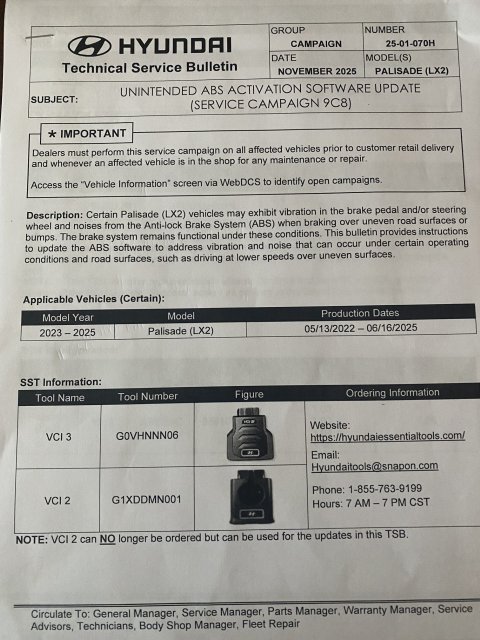

cflo
Whelp apparently the fix is in...a NEW TSB just dropped this month an ABS software update...here's a pic of the TSB tsb.jpg
