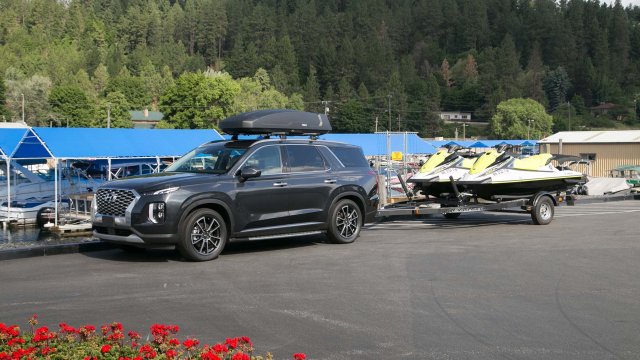

I plan on doing a small trailer, mainly for my jet skis.
