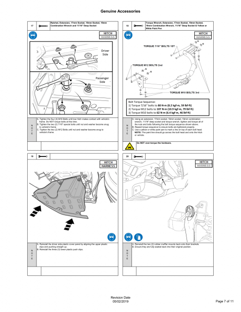

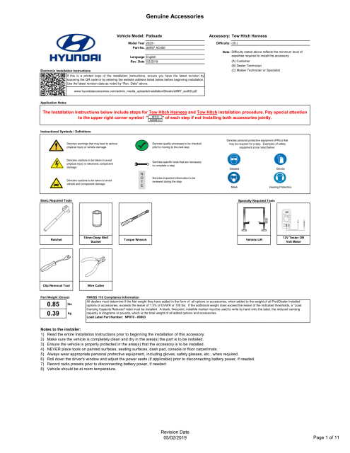

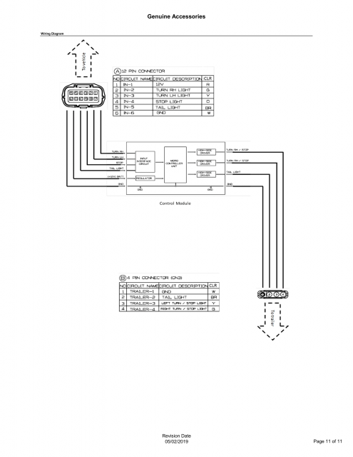

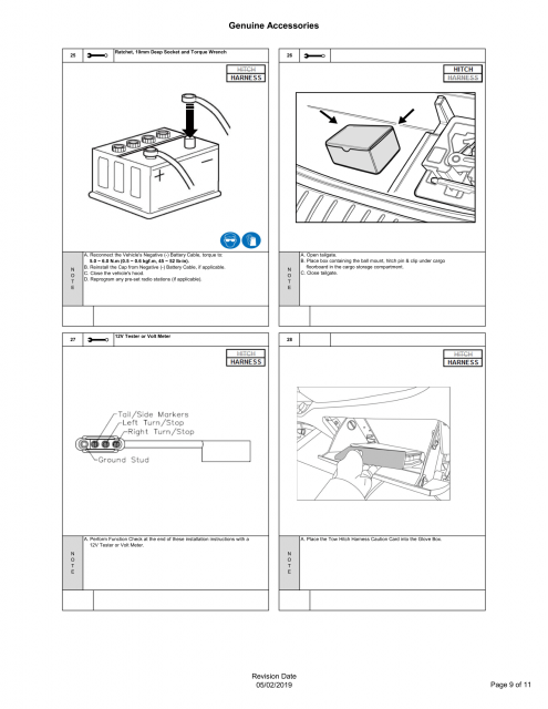

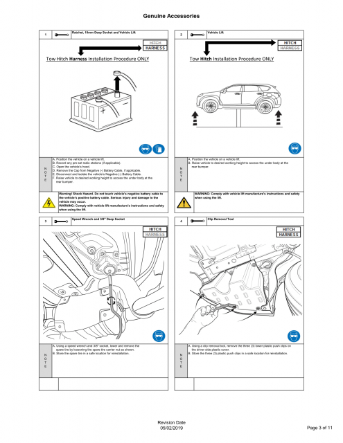

J Jaylima72 Member Jun 21, 2019 #1 Messages 42 Reactions 8 Jun 21, 2019 #1 Tow Hitch Harness Installation Instructions Attachments s8f67_ac400.pdf 3.1 MB Views: 33
T Twbrans New Member Jun 30, 2019 #2 Messages 9 Reactions 9 Jun 30, 2019 #2 Great help. Thanks. 1 Show All
Y yanni New Member Nov 7, 2019 #3 Messages 12 Reactions 3 Nov 7, 2019 #3 so I still have to run separate wire for 7 pin?
A awd_madness Member Nov 7, 2019 #4 Messages 67 Reactions 14 Nov 7, 2019 #4 yanni said: so I still have to run separate wire for 7 pin? Click to expand... Yup
Y yanni New Member Nov 7, 2019 #5 Messages 12 Reactions 3 Nov 7, 2019 #5 That's unfortunate . I want a 7 pin harness built in like the Ford explorer.
