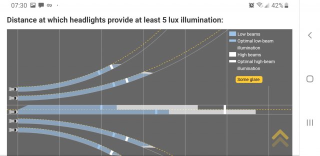

Speaking of fabulous headlights, the only complaint my wife has is the "divots" in the sharp light edge at the top of the field of illumination just forward of the driver's left fender. When we pulled up to the closed garage door, the right headlight has same divot, to the left of centerline of the passenger. When 25 yards out, the divot is a noticable dark hole, especially when shining against vegetation, cars, and buildings. After driving NE, Utah & Montana for a few years, the deer / moose reflex still kicks in.
I called it as normal for projection LEDs, especially as both are exactly same.
What say you? Thx.

I assume you mean the V-shaped dark area when you say divot. It’s normal and it’s there to avoid blinding oncoming drivers. On other cars, instead of being a V-shaped drop, it just drops completely on the left side (the right side illuminates higher). So you actually get more light with a V-shaped drop than you would with many other cars. If you looked at it from above, you‘d see light going far on the left, then a drop on distance to the left front (oncoming traffic), then light going far again on the right. If you look for the IIHS test charts for the Palisade, you’ll see it. And the Palisade LED lights are very bright and reach as far without high beams as some other cars do with high beams.

Thx, that makes sense. Picture from IIHS for 2021 Palisade.
Yep, that’s it. The V-shaped drop is that center left area which doesn’t illuminate quite as far.
Another thing: your screenshot doesn’t show the distance at the bottom of the chart, but if you go back and look at it, then compare it to other cars, you’ll notice that the Palisade reaches quite far.
