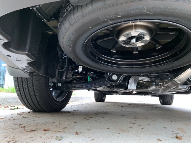

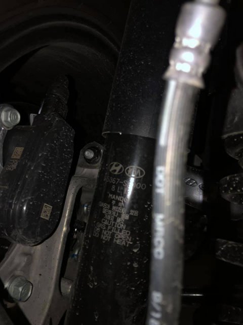

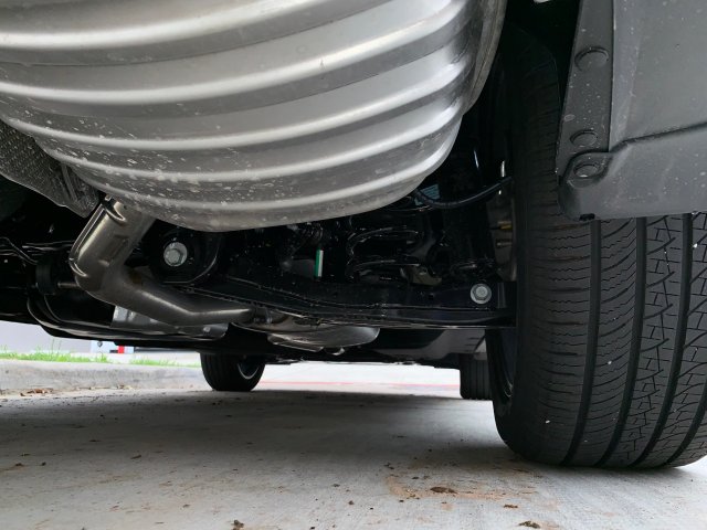

Here are some pictures on what the auto leveling suspension looks like up close.
IMG_5302.jpg IMG_5314.jpg IMG_5316.jpg 57155367_2451511764860006_2873949775248490496_n.jpg 56582212_2451509154860267_2949210714809565184_n.jpg
yanni
I thought they were oil filled...Thanks!

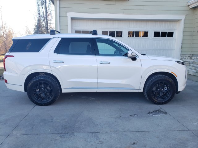

I put a 2 inch "lift" (leveling kit) on my Palisade and now it rides high in the front. I think the self-leveling got messed up somehow when I did it. Anyone have any idea how to adjust it to be higher on back so it is level again? It doesn't look like much in the picture, but it is enough that oncoming cars flash me as if I had my brights on.

The Palis don't have the typical self-leveling suspension; it has self-leveling SHOCKS only. And they're not adjustable. You'd have to buy different ones for the height you need, and good luck with that :).

Not sure what lift kit you used, but looks like it was lifted higher in front than in back.
Does the kit use the OEM self leveling shocks? they are not adjustable.
